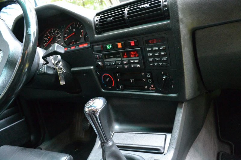

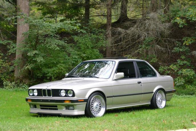

    This is what the car looked like right after it was completed. Thanks to Brandon White at Fear Photography for taking a couple of these pictures.

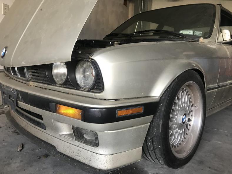

    This is the E30 as it sits today:

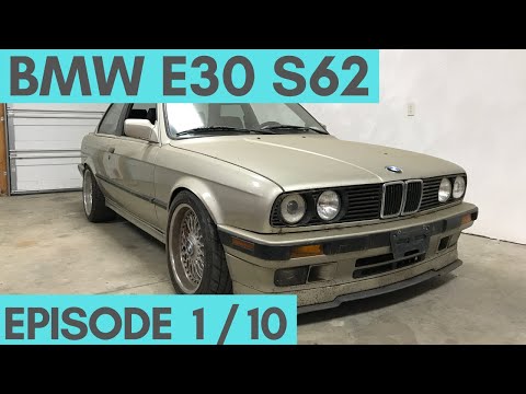

    So overall what needs to get done?
    Definitely a detail/wash
    New Tires
    New Control Arms, bushings, and alignment
    fog light bulb
    cluster issues (tach, fuel gauge, coolant level/temp, cluster lights)
    Air conditioning condenser/drier replace
    Headlight restoration
    Seatbelt replace, interior detail
    Rear Automatic Flyout Window Restore
    Fluid Flushes
    Antenna Mast Replace
    Other small Items
    Intro video here. This is video 1 of 10 that I plan to release in August!

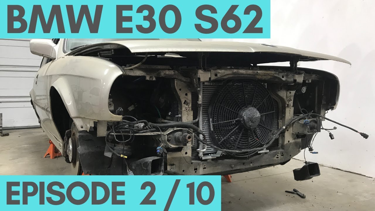

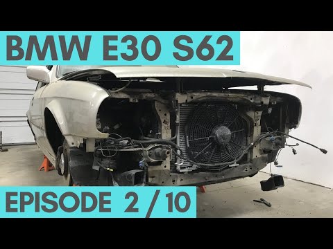

    And some more progress pictures. I replaced the series condenser unit with a parallel flow condenser unit. This will allow for better R134a flow and colder air coming out of the evaporator so I was excited to put this Spectra 7-3464 in there.

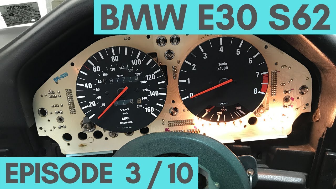

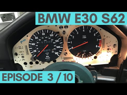

      So some more updates! Worked on the instrument M3 cluster. Found out that the pressure of the plastic frame on to the printed wiring board actually created cracks and opens in the actual copper traces. Hard to identify and took some time, but I got there.
      And the third installment video of me identifying the bad traces: The original problem statement was no left turn signal light and no light for the cluster itself. Naturally, I checked the bulb, then started tracing from the pins of the WHITE C2 connector on the back of the cluster to identify that there was in fact a trace that was broken. Just soldered a jumper wire and fixed the 2 problems. Find out how I did it!

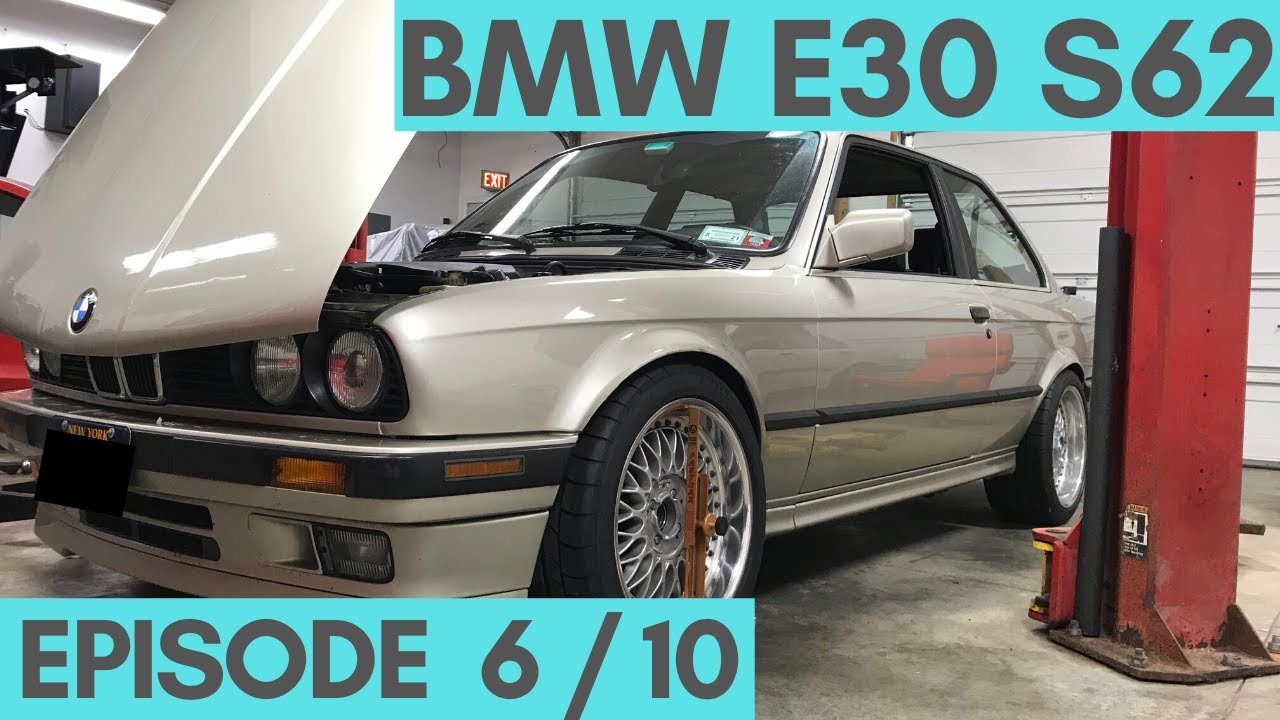

                  Now, in episode 6, we replace the front control arms and fully align the front end of the E30. I show you how to use alignment plates to align the E30, getting that slight toe-in necessary. I also use the camber measurement tool to dial in the camber as well. Pretty useful for quick on the fly camber adjustment!
