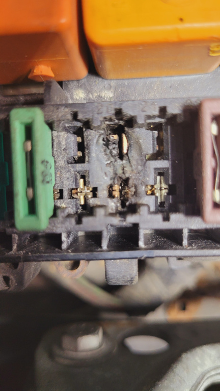

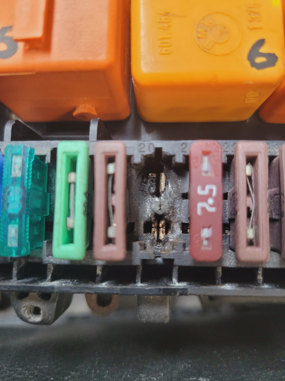

    Engine bay is also a mess but main issue is many of the plugs themselves have disintegrated in addition to the random unknown wires that don't connect to anything. Fuse box has also seen better days and the AC fuse melted pretty bad and appeared to have some random copper strips jammed in to make a good connection which I've fixed up and re-melted back into being servicable shape.

      Yeah good idea tbh, I'll get one. Attached a photo of where I removed a melted fuse. The melted one was rated at half the amps of what it's meant to be from factory, but this car has a R134A conversion so not sure about that. A/C stopped working one day and I pulled a blob of melted plastic out as well as what looked like some random copper strip to make a connection. Have some documents that say it melted before so I think it might have been a half-fix. I managed to re-melt it back into where it can hold a fuse without needed copper strips to make a connection and put the stock amp fuse back in.

      Fuse before:
      Fuse after (highly professional fix - but it at least makes a connection now):
