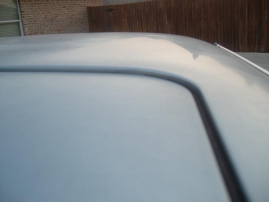

    I am wondering if anyone knows how to adjust a sunroof for heighth. If you know of a link to an article that would be great too. I searched on r3v but every thing I came up with was about leaks. My sunroof is dipping in the back drivers side corner. I have not seen any evidence of leaks so my drains must be ok but I would like to get it even. Thanks.
