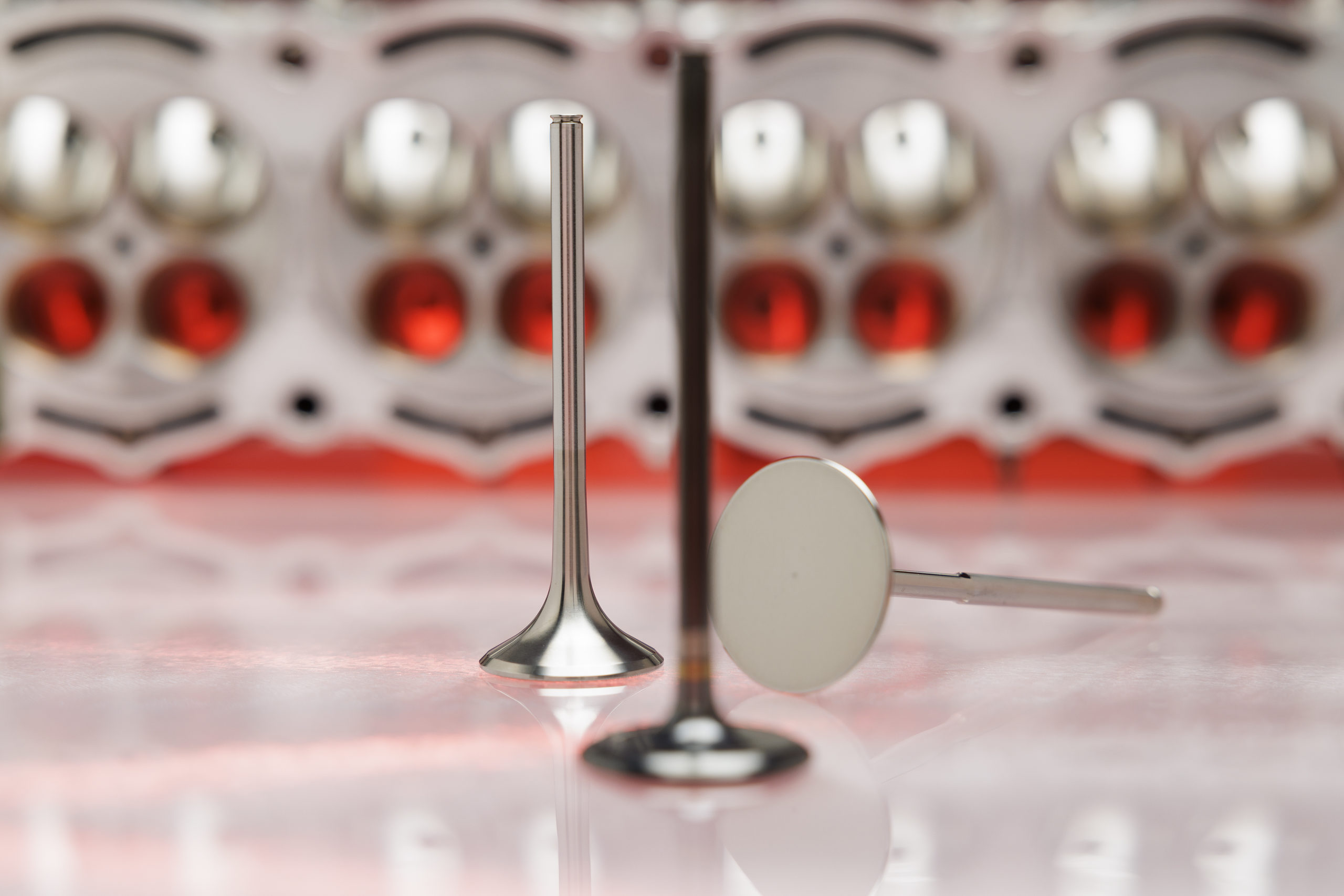

      You can contact a number of suppliers to have larger valves made.
      Del West is an amazing valve company.
      Nos produits allient la précision de l'ingénierie aux possibilités des matériaux exotiques, offrant des solutions de haute performance pour diverses industries.
      You can also contact Manley and Ferra(sp?)

            Valve's can easily be cut to the correct length by a competent machine shop.
            However, you forget to bring up the point that the larger valves and valve stems also WEIGHT more. The name of the game is to REMOVE weight off the top of the valve -- not add. Therefore, this is why one for true performance gains should have custom valves made (some companies already make them) in the correct stem width and they will also be lighter. :)
