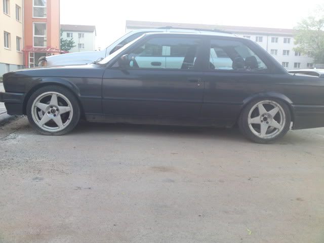

            I would hate to sell this thing. I put 4 months and about $2000 into it. This site funded my car. Thanks to everyone that has bought euro goodies from me. I think I could ship and convert it and sell it and break even in the states. All parts have less than 200 miles on them. Here are a couple cell phone pics before I double stacked rear spring pads and took out the front ones. New Billies and IE3's
