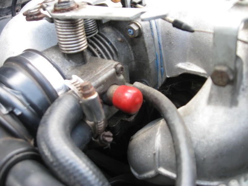

              as you can see by this picture I have a capped off vacuum port... where does it go?

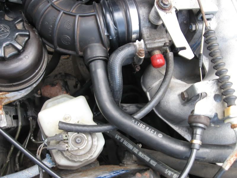

              and in this picture you see a small vacuum hose that is sitting on the brake fluid resivor....
              it goes on this what looks like charcol canister I saw a picture that this connected to some check valve, it was white. I was inline from this hose to that check valve, to another hose that connected to the cannister, Can't for the life of me find that image.

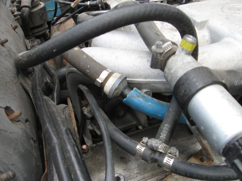

              This picture has a hose that is from he brake booster, the replacement hose is the blue one, it sorta fits... but I'll be replacing that, possible culprit?

                dude....the red-capped thing on the TB is the outlet/inlet for the crackcase ventilation!!! The hose usually runs from there, under the manifold to another big-ass nipple on the side of the valve cover. ALSO, your electrical taped intake boot is also suspect.

                  HA! I knew there was a CV system on this car... stupid hole is under the intake manifold, Found it, not I am sourcing the hose from pelican

                  I know the boot is a prob, but this is the main culprit... any clue on the other small hose that goes to the charcoal canister? remember seeing a white or black check valve inline to it too....

                    the valve thingy I'm looking at is the charcoal canister bypass valve.... but to no avail finding the part on pelican or realoem...
                    anyone have a part number or alternate name?

                        update... found out the part for the charcoal canister bypass valve is actually called Non-return valve Part no. 1163177770

                          The idle control valve is in the picture with the blue hose. It needs a good boot and hoses to work properly.If the icv is bad , a trick is to take a penny ,drill a quarter inch hole in the center, then place it at the intake side of the valve. Should even the idle out at about 700rpm. A temporary fix. Also check the temp sensor ,sending signal to the comp.I had nothing but trouble until I bought a new valve and all new rubber.- Steve
