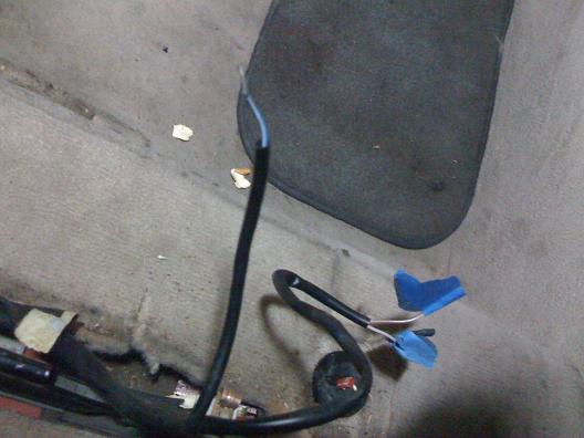

1. While I was removing the center console I had to disconnect the rear ashtray light wires. There was a third wire (blue/white) that I could not find a connection for. After reading some and checking the ETM it appears that this may be the reverse light wire, something I never bothered to check and cannot check at the moment since I am in the middle of a tranny/engine seal/gasket replacement so the tranny is disconnected in most places and is almost ready to be pulled. If this is the reverse light wire, how is it routed to the tranny? I checked under the car and could not find an obvious route. I have attached a pic of the wire. Everything I've read is really, really specific to the manual tranny but that leaves us pour auto-tranny people needing to keep searching for an answer.
