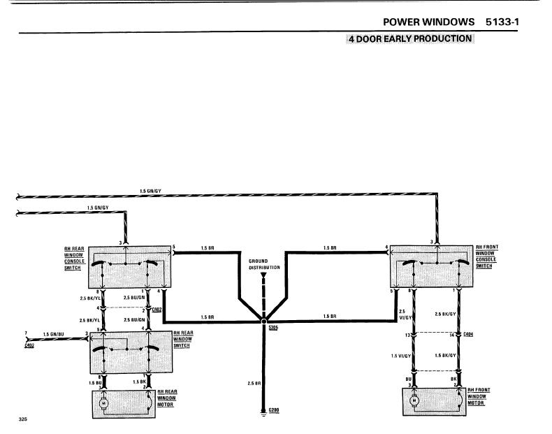

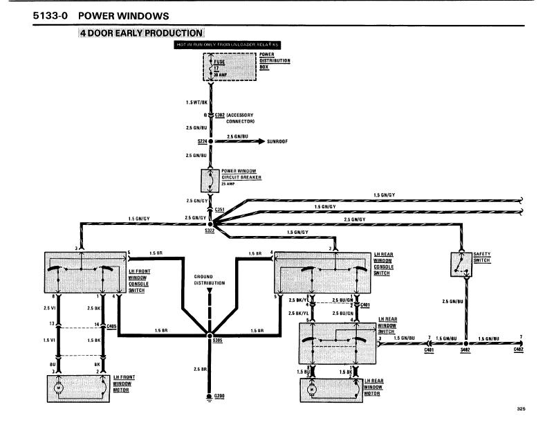

      That's a very strange issue. The motor should stop when you let off the switch I would assume. Attached are some electronic diagrams.

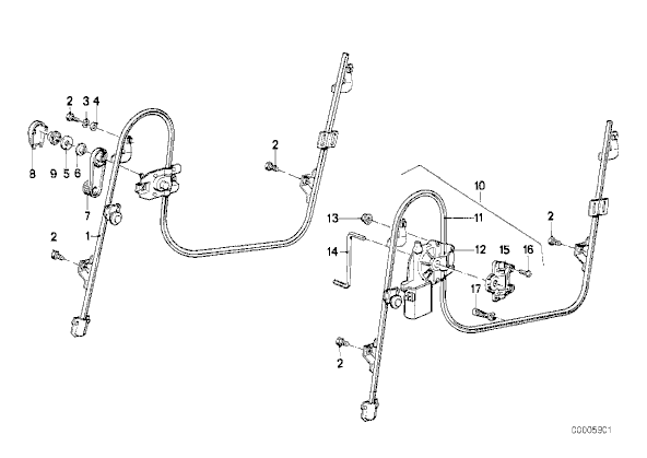

          What part are you referring to as the regulator Luke--#11?

            5,6,8,9...something in there craps out
                Those #'s only apply to manual windows...
                  yeah, good catch, Trent.
                  OK, so there is a clampie thing that hold the sumbitch I am talking about to the gear drive track, I think that is 15...so it is the part that spins to make the gear track move, does that help?
                  Pull the damn thing out of the car and run the motor. You will see instantly what I am talking about.
