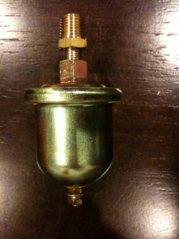

    Where is the Oil Pressure Switch on M20?
    I can't seem to find a good picture of what the oil pressure switch looks like on my IX and where it goes. I read that its just below the oil filter but not sure what to be looking for. I got the part below from Autozone, but I can find anything like it on my engine in that area. Do I have the right part even?
    I need to get this resolved as my oil dummy light is flickering dimly. I am hoping its just the switch.

    its where the block meets the pan under your oil filter if i remember correctly., that doesn't look like mine either^

      The previous person is right for the location, single wire with single terminal clip on. If iit is leaking change it for about $4.00.
