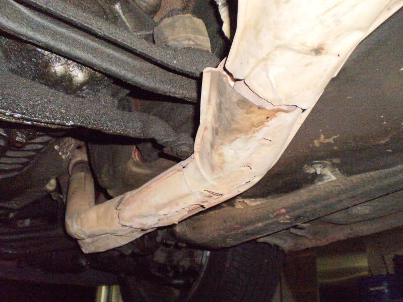

          my car makes the same sound around 2200 rpms befor or after sounds good. I found out my heat sheild is also broke an is making noise. But I think the trans has somthing to do with it at 2k
            heres a vid I took lastnight. Cant really hear it and the loud thing you will hear is my hood falling lol ,
            pic of the head sheild
              Thanks for the pictures and video. It's not quite a ticking noise like that, but more of a rap-tap-tap-tap as I pass through 2k, if I stay at 2k it'll be a constant rapping type rattle.
              Also, the heat shield I'm talking about is the very thin one bolted to the underside of the body to protect it. I can't seem to find a good picture online, and I forgot to take a picture when I was under the car.
