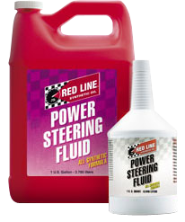

                        I used Redline

                          how many horsepowers did you get by switching to the redline fluid?
