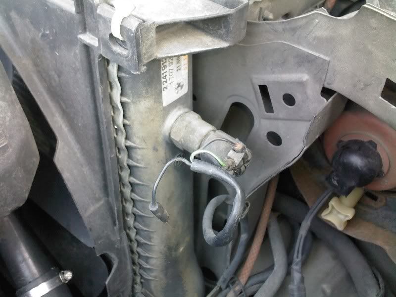

    So, I noticed there was one wire of the three connected to this plug was brokem. I have no idea for how long.
    It doesn't seem to adversely effect my engine in any kind of way, but maybe i'm just oblivious.
    This is the passenger side of my m20 radiator. Should I replace this plug.
    thanks guys

    It turns on the aux fan I think.

      AUX fan switch is correct sir

        thanks! so i should get that fixed real soon huh?
        Does anyone know the part number for the side with the wire leading to it?
        i got the actual sensor part number 61311378073 but i can't find the other side

          realOEM.com

            Yeah i've been looking everywhere on that site but i can't seem to locate the other side of this plug/sensor.

              i would just go to a junk yard cut one out, and solder it back in...if you do cut one out, DO NOT BUTT CONNECTOR it together on your car

                  good point, thanks 5kwattson
                  for the time being i don't seem to have any problems. i ended up ripping off all the wires when i tried to remove the plug... :(
                    What? Why not?

                      I'm assuming the resistance in the butt-splice will give a false reading.
