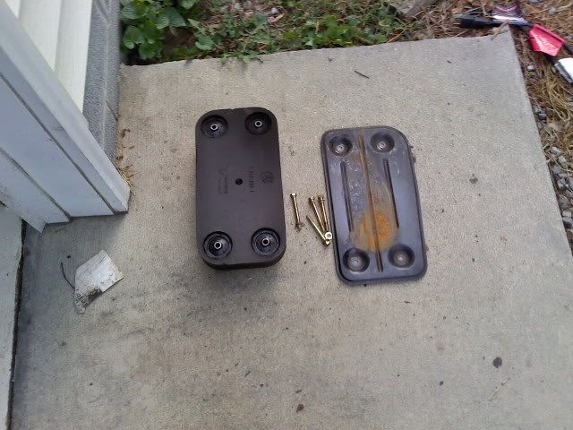

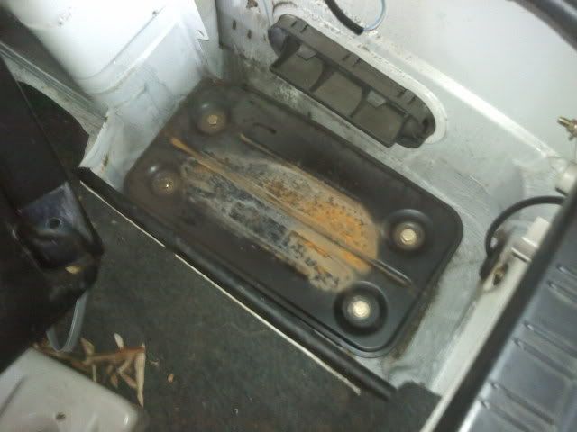

Alright folks, I nailed it!
It was a fucking piece of iron, presumably placed there to prevent the upset of balance since the battery is in the trunk. The front bracket broke and this thing was flapping around like a fish. Geeeeeeeez, that one almost drove me over the edge.
87 535is TCD S2
