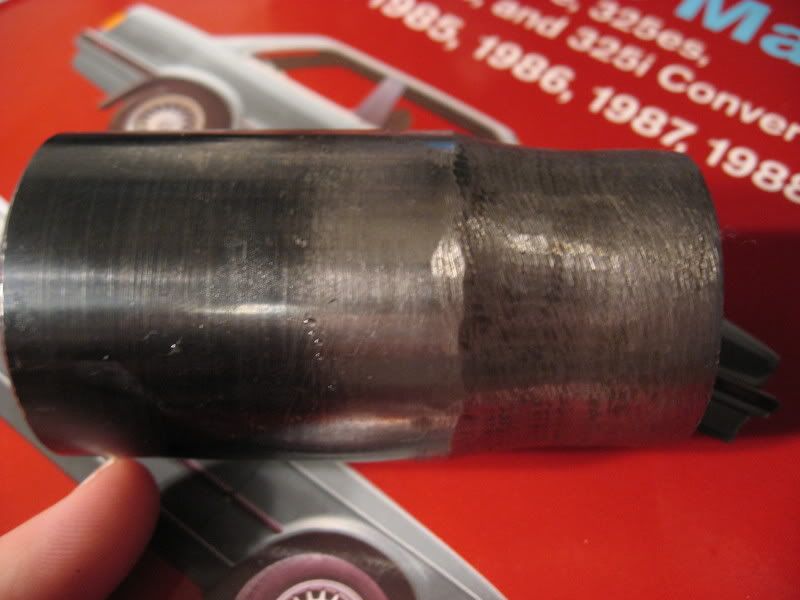

    its easy. go to harbor freight and get the deep wall impact socket set. go to a grinding wheel and take about half the meat off of it for about an inch.
    cheap and easy.
    • 87-325ic
      • Apr 2006
      • 1198
      cause im feeling nice.
      ps, i didnt have to take that much off, but i didnt want to make two trips. but, much bigger and it still wouldnt have fit. its Tight.

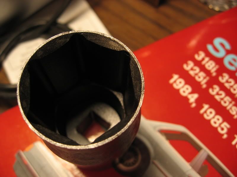

        go to checker (or their variant in your area) and get part number 648445. this is a thinwalled socket, 1 3/16 deep. designed for use on oil sending units. fits the nut perfectly, and gets into the well in the yoke. Nut is tighter than hell, but it will come off. best part, if you break it, lifetime warranty.

              Transmission output flange nut
              Socket needed 30mm (1-3/16" = 30.16mm) deep thin-walled socket
              Maximum diameter 39mm
              Internal relief: minimum diameter of 15.5mm to 70mm deep
              ST Tools BMW3025 socket $40-$50
              39.04mm OD, 16mm deep flats, 66mm deep
              Powerbuilt Tools Oil sender 1-3/16" 648445 $6-10
              37.85mm OD, Internal relief: 19mm deep flats, 30mm ID to 67mm depth
              28.43mm wrench flats on end, actual size 30.30mm (+1%)
