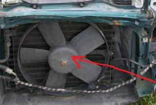

    Hi My 325e 1986 Goes over heat but when i go ... on the road fast it goes cold again , but when there alot of cars and i am driving slowly it goes over heat , plz help me what i must do??
    and i dont have this fan ?? what i must do ? should i put one like this or what ?

    The fan shown is the aux fan. It is only required when the A/C is in use idling or in stop and go traffic. The engine driven fan should be more than enough if the fan clutch is good. It sounds like the fan clutch on this car needs to be replaced.
    Jim Levie, Huntsville, AL
      Not this car man , this is just a photo for the fan

                  then i added this fan ... with a thermostat when it want to go over heat this fan will workkk and cool it .
