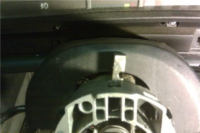

    The steering lock can be removed. You have to unlock the steering an pull the wheel. Then it is just a matter of removing a pin and pulling the lock bar.

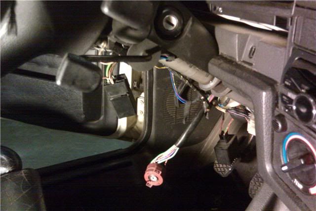

            So I did get to work on it a little later...
            SUCCESS!
            Thanks jlevie
            Removed bolt
            Tried to pull the pin. Then got bored... so I drilled out the punched end, cut it and pulled it out. I have other pins just like this from spare AR-15 parts, so I could still reinstall the lock.
            Now for the button start! so far I've only collected the hardware
            I'm currently searching the pins that I need to solder to... Anyone got a link?
