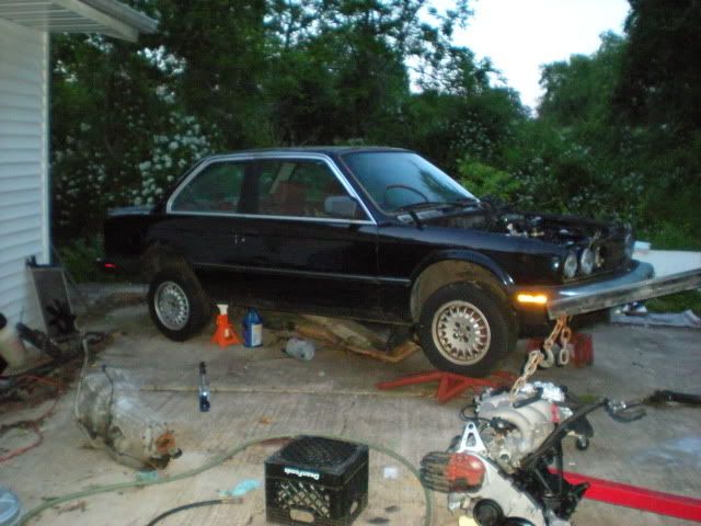

hello all! i guess ive found the right place for this project, i saved this e30 from the junk yard two years ago, i just got around to putting a new junk yard motor in it. ive been in the autobody business for over 20 years and have never owned a toy car, so when this came in with a blown motor i knew i had to have it. i know my photo's kind of stink but i haven't been properly documenting what ive been doing....duh... so i will take some more photo's later, this car has NO rot in it, its never been painted anywhere, as a matter of fact the orginal cosmoline was still all over the engine compartment.
fireing it up
so far i have less than 1000$ in this project, eventually im going to pull the seats and carpet, apparently over the last winter a mousy decided that the glove box would make a wonderful home so the inside of the car has the distinctive funk of mouse piss, the drivers' seat is all tore up (190k will do that) but i think for the time being im just going to put seat covers on them.
i drove it around the block on saturday, after i hooked up the exhaust, the motor seems to be running perfectly. it shifts fine and kind of stops, there's two years worth of rust on the rotors so they are going to get replaced with some up graded ones.
