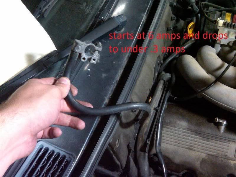

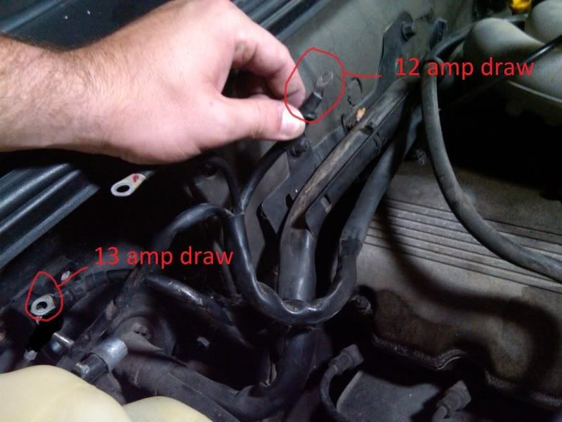

                      So here are my findings after some more digging.
                      The 12 amp draw runs into the fuse panel on the strut tower. What is odd is that I get almost no change im amperage draw when I pull the fuses and relays. Is it possible that the fuse panel itself is bad ?? This just doesnt make sense to me.
                      The other highlighted wire connects to the main wire bundle so im not sur eif this will help me track down the draw or not.
                      The main bundle, the only thing I find weird is the trickle down in amperage.
                      What do you guys think ????

                          I have tried looking through my bmw service manual and through the hanes manual and cant figure out where the other positive cable goes. Obviously I know one goes to the fuse box. The other one that connects into the largest wire bundle where does it go ?
