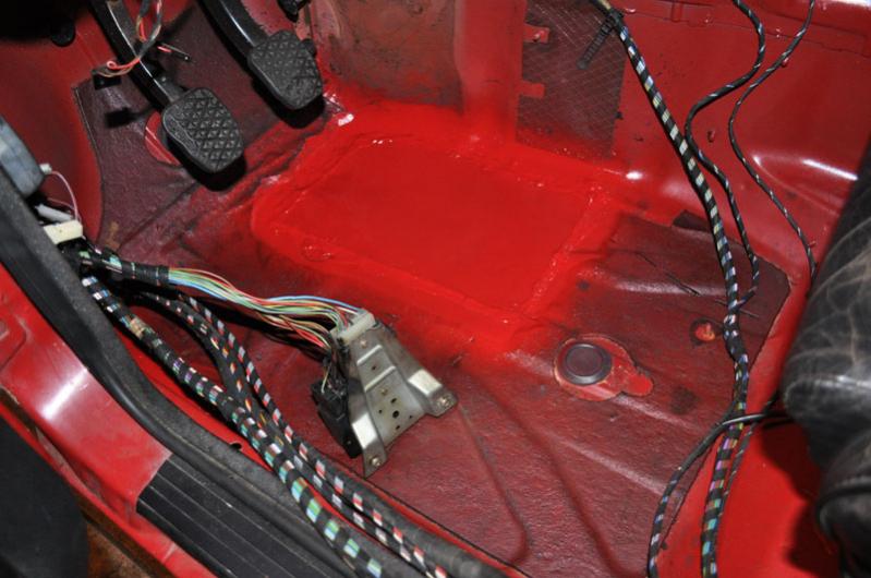

    I searched here and realOEM. What is the piece that holds the pedal into the floor. Is it part of the floor pan, welded in place or something that can be detached? If someone could get me a part number even if it is NLA or the entire floor pan. Thanks

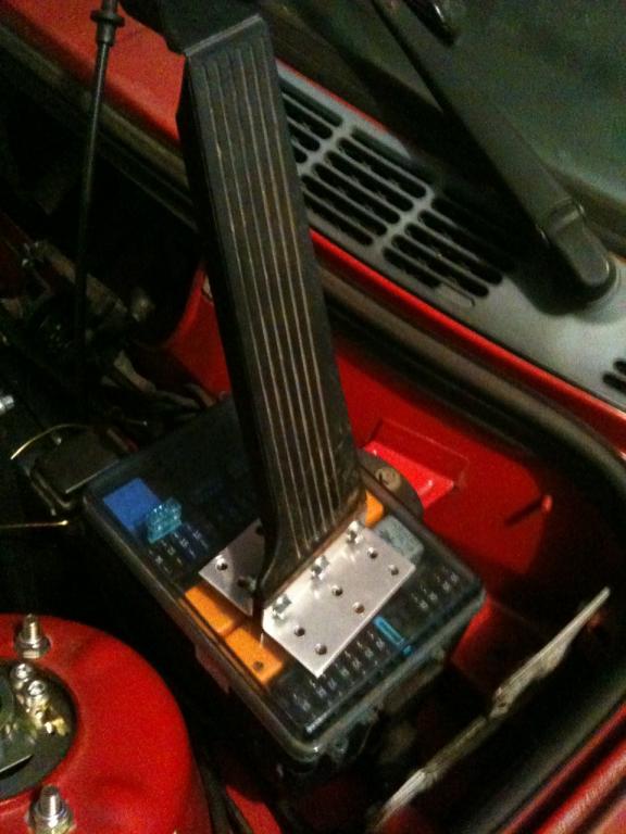

    I couldn't find any part numbers either, but can show you a picture of the brackets I made for mine after I cut and re-welded the floor pan there. It's pretty simple. Let me know if this would help.

      The "clip" is part of the accelerator pedal and simply snaps into the floor pan (part 35411156488). If the floor pan isn't rusted out you can just replace the pedal. If it is rusted out you can bolt a hinge to the bottom of the pedal and to the floor pan.

        Sadly it is rusted out on my good car. My parts car seems fine, however i don't know if I feel like cutting up the shell. Hinge sounds like a good idea maybe I could tack it to the floor?

          Here is a cell phone pic of the brackets. I used .080" aluminum because that's what I had available. Two pieces of thin angle aluminum from Lowes would work just as well. You don't need a hinge on the bottom because the pedal itself acts as a living hinge at the top and bottom.
          For the floor, I welded a piece of .060" sheet steel in the floor. It is overkill, but it's what I had laying around. Then use a seam sealer from an auto body supply store and paint.
