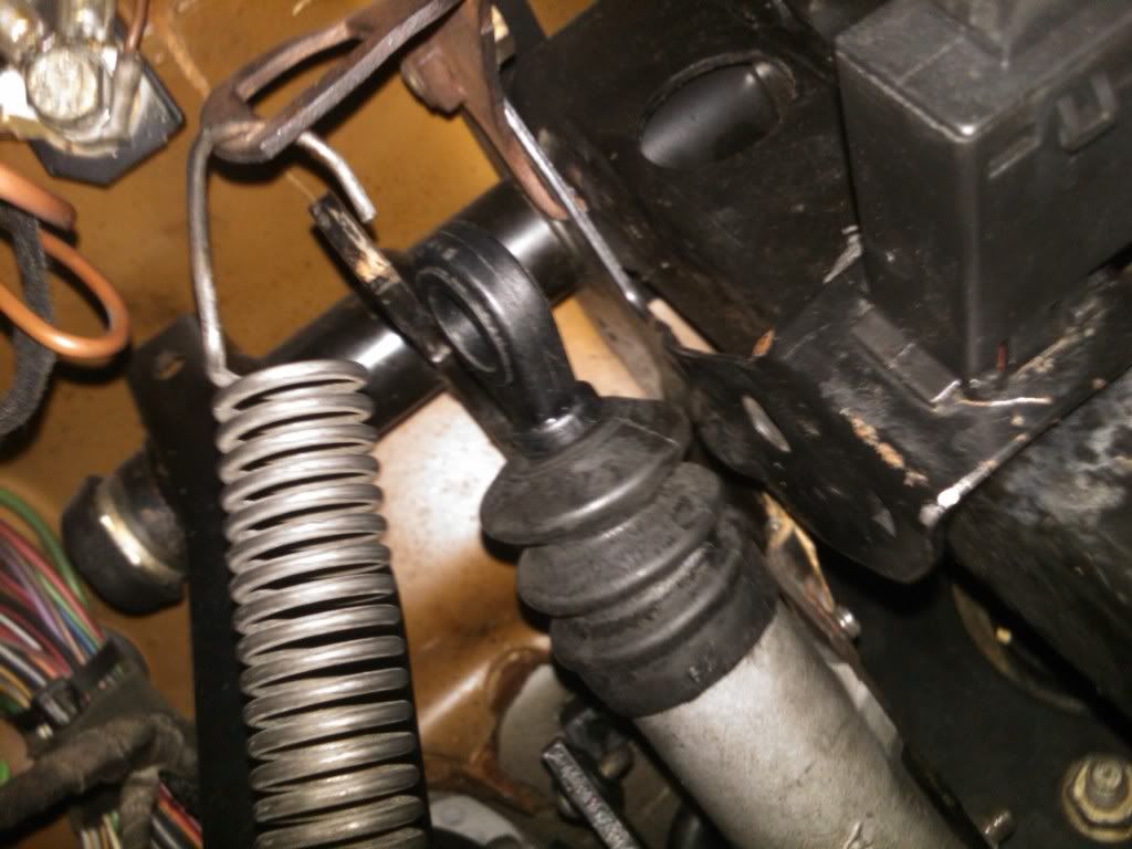

                      ok, so got evcerything in, except the 'pumppistonrod' at the end of the master cylinder. I accidentally pushed the clutch up into the well. So now it sits higher than its supposed to be. I took crapola cell pics. What exactly do I adjust on the clutch pedal?
                      Thanks.
                      www.woranges.tumblr.com
                      • Adrian_Visser
                        • Jun 2006
                        • 2823
                        Wtf dude are you serious? Hook up the shear pin that the clutch master attaches to. The reason the pedal is up so high is that the return spring is pulling it up all the way and there is nothing to stop it.

                            Allright cool, I assumed the other master cylinder was destroyed cause the clutch pedal/spring was too high.I thought the end was pulled out of the first replacement master cylinder. So triple checking as I don't want this one to pop
