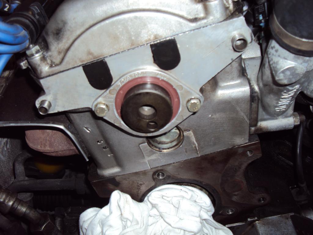

    camshaft seal and o-ring?
        Good one. Might as well do it "while I'm in there".
