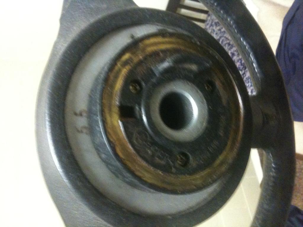

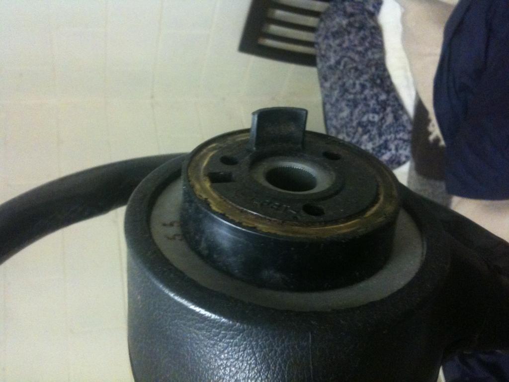

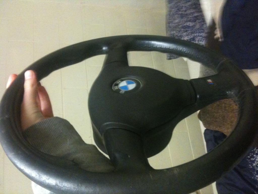

    next question is, i bought a m-tech II wheel, and it doesnt fit. it slots on the column. but it leaves a large area exposed. its also a screw not a socket :???:. so its possibly from a m5 ??
    pictures to illistrate the wheel boss:

    Thats not an e30 wheel. The back of an e30 looks more like a lemon juicer bowl. lol
