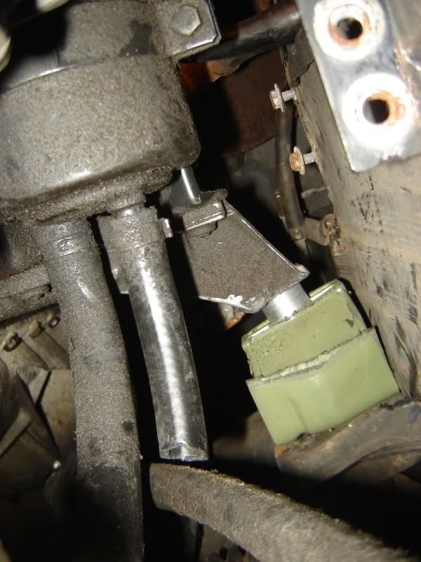

    i can make spacers.
    That's what i made to raise my oil pan on my m50 swap. it's a 1/2" tall spacer 1" diameter. I can make them bigger if needed.
    90 325is alpine2 m50b25 becoming a dorifto car.

      im assuming you're referring to the metal piece, but it looks like you've cut/stacked urethane mounts as well (its my first time seeing a mount, new to e30 mechanics)
      how does the car ride?

        I didn't stack anything. i machined a solid aluminum spacers and put it on top of the motor mount. there is an m50 in my e30., it's not the m20 mount or motor. it rides fine, i don't feel a difference. it's just like having the arms sit normally on the motor mounts themselves, just higher up.
