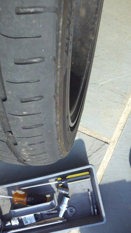

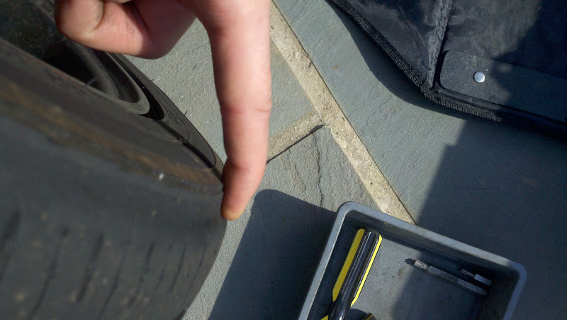

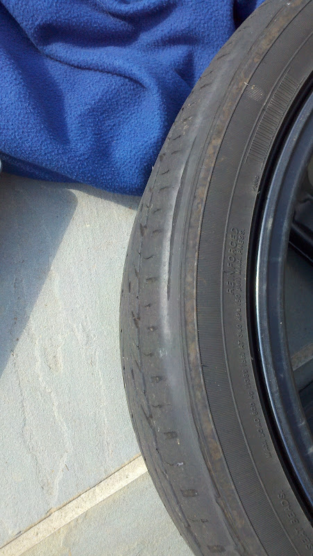

    So I realized last week that I really needed to rotate my tires on my DD, and finally got around to it today. I had the car aligned last year, the tires are Yokohama Avid H4S, also got them last summer. Now, I would consider my driving 'spirited' - as I live on some back roads in Oakton (VA), but this tire wear is rather alarming:
    its only concave like that in one section of the tire, not the whole circumference. I'm guessing that my camber is a little off, but why the divot?

      I need more information. Is that a front or back tire? Is the suspension stock or modified (and if what mods)? From the pictures it looks like the wear is on the inside edge, correct?

        car is a 2002 Toyota solara, (FWD) that is the front drivers side tire, the car is lowered on Eibach Pro-Sports and Tokico blues

          toe out and camber killed it.
            toe is the alignment between the front and rear of the tire correct?

              yeah.
                btw - not bad for a cellphone camera huh?

                  so how would I correct that?

                    Alignment and proper tire inflation.
                      damn... how would a car get so misaligned in a year?

                        Something broken/bent, you did suspension work to it without an alignment after, wear on components.
