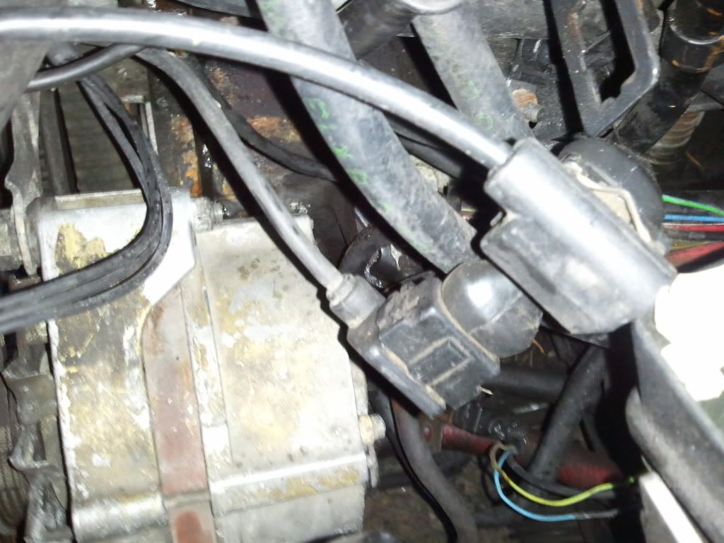

    anyone have any clue what these might be for and if it's stock?
    You had an animal work on your car.

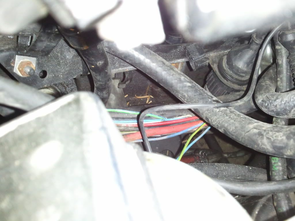

    They all look to be stock wiring, just heavily butchered and misrouted.
    -Dave
    2003 Lincoln Towncar | 1992 BMW 325iC | 1968 Cadillac Deville
    Need some help figuring out the ETM?

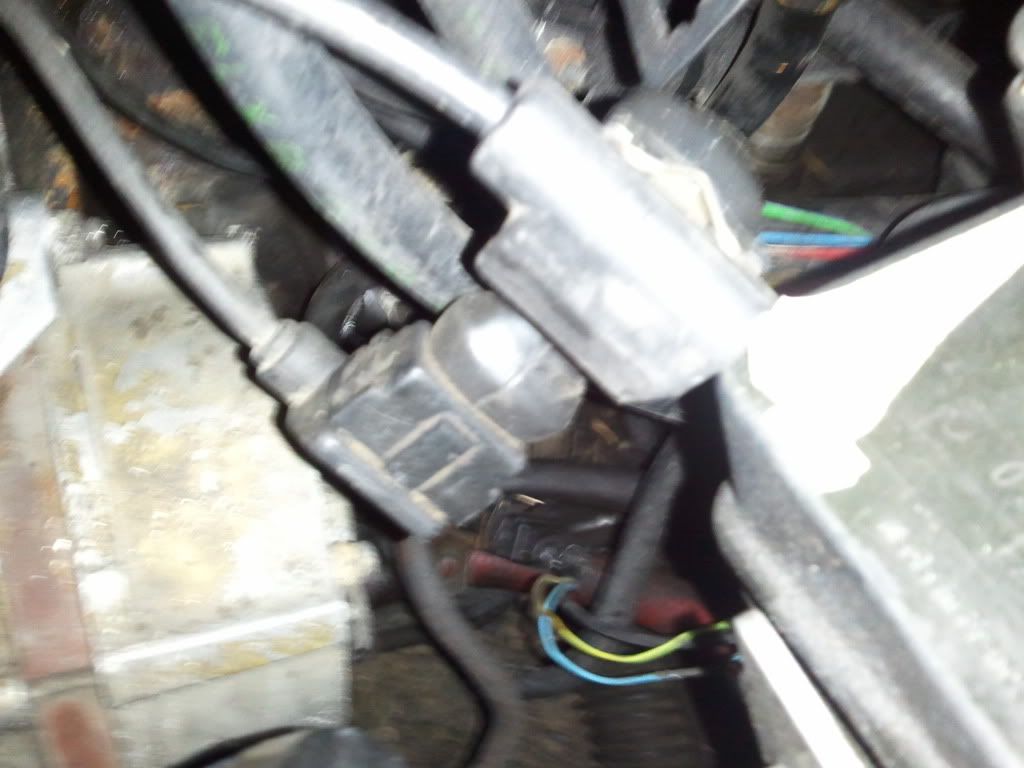

      first one is the oil pressure sensor,
      second is the oil level sensor
      like he said hacked up

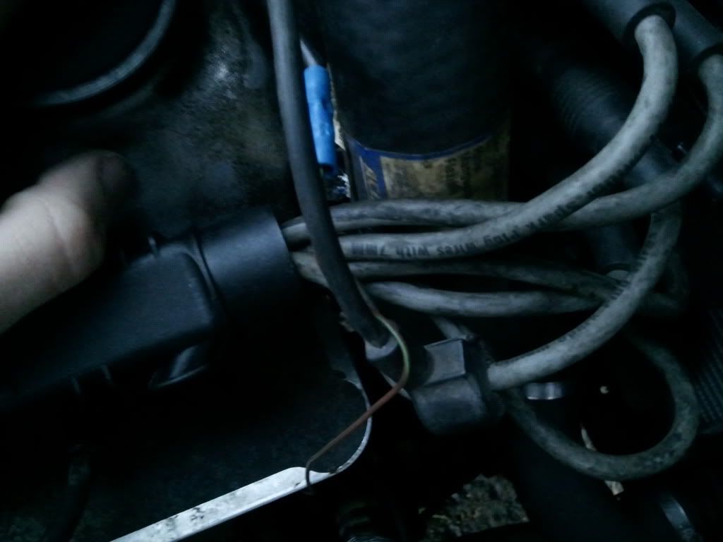

        Yeah I have noticed allot of it has been butchered, had to remove a car alarm and relay from under the dash that was spliced in... not fun. so the little wire that fits over the spark wire is also stock? it looks so out of place haha.
          The "little wire that fits over the sparkplug" is the Cylinder ID sensor and is found on all M20B25 and SuperETA engines.
