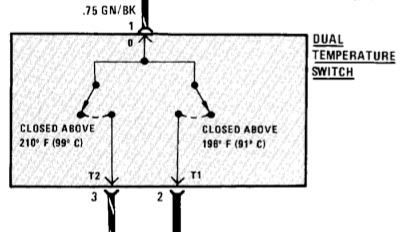

    I have a question about this diagram/stock radiator thermo-switch. If the 91 c side closes and the temp continues to rise then the 99 c closes, is the 91 c side still closed? So both are closed at the same time?
  • DaveSmed
    • Apr 2007
    • 1407
    Yes.
