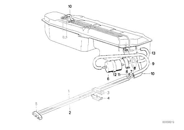

    #13 --- Is this a pre-formed / pre-shaped hose, or a cut length of "standard" fuel hose?
    Part # is 16121180398.
    Mine has a split and I need to replace it. It's about 3-4" long.
    13,9,and 10 is standard" fuel hose i think.
      Awesome, thank you.
        what size fuel line would one use here?

          5/16" fuel injection rated hose will work. Plain fuel hose won't take the pressure.

            It is actually a pre shaped hose if you buy it from the dealer by part number. Its the samepiece used at the fpr on the rail also.
