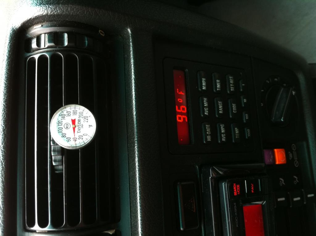

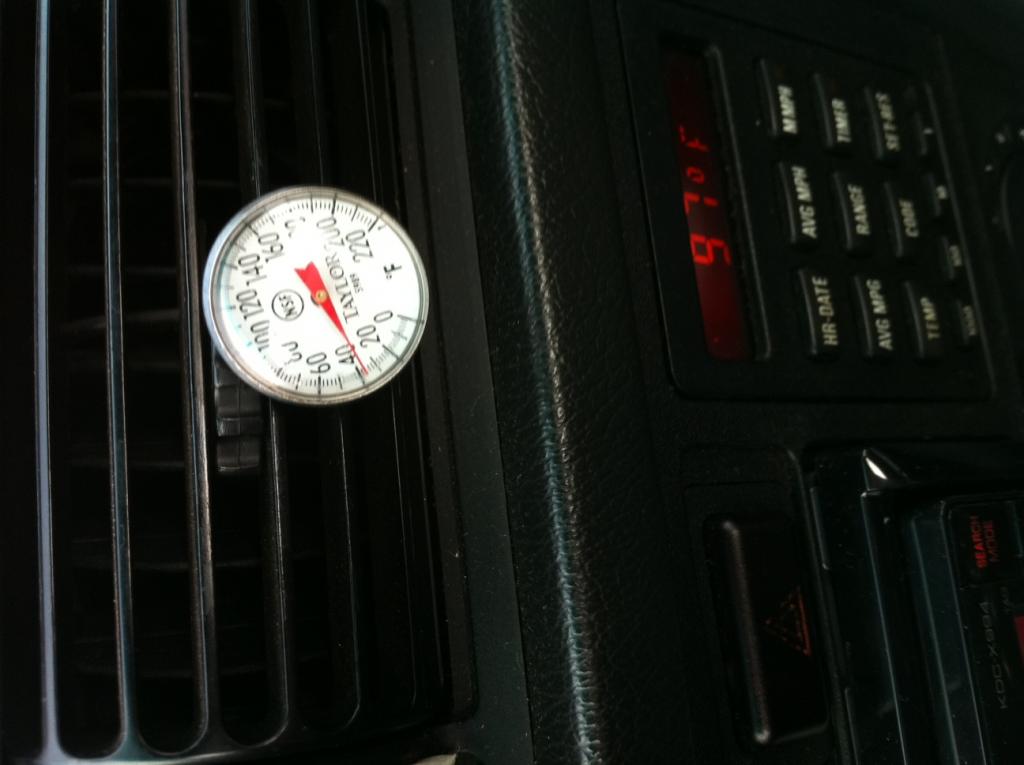

              Well... I had to turn on the recirc function to get good performance (especially as it was really humid that day). On the other hand, I still think R134a performed reasonably. The following pictures were taken at fan speed 4. The TWC App said 93 degrees, so I believe the OBC temp sensor was reading accurately, after all it was sunny and pavement soaks up heat.
              Highway:
              Idling for 5 minutes:
              It's certainly true that R12 is better, but the fact remains that R134a can provide perfectly adequate service.
