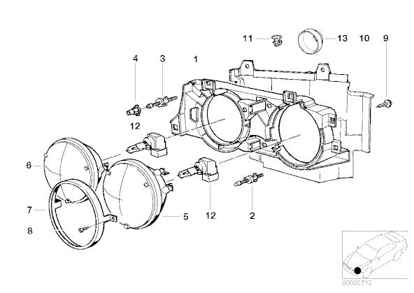

    The plastic panels that cover the headlight area in the engine bay- can anyone tell me what they are L and R? I can't seem to dig them up on realoem. In this diagram I think they are #10 but they're not listed below. Also, not sure that it matters 318i/325i but my m42 airbox cold air snout looks like it plugs into the driver side panel. Thanks in advance.
    it is number ten driver side has a hole for the airbox hose to connect, the passenger side doesn't. i don't think it matters from what e30 they come from at least not from any i have come across.

            Couldn't find it on this site either. The only pic I can find of it is that one with the light components - but it doesn't provide what #10 is.

                    Part numbers 51.71-1965252.9 pass side drivers side 51.71-1965243.0

                          86 325e
                          517119161949
                          514319432779
                          88 325i
                          51711965241
                          51711965252
                          hope that helps they r around 8 bux each
