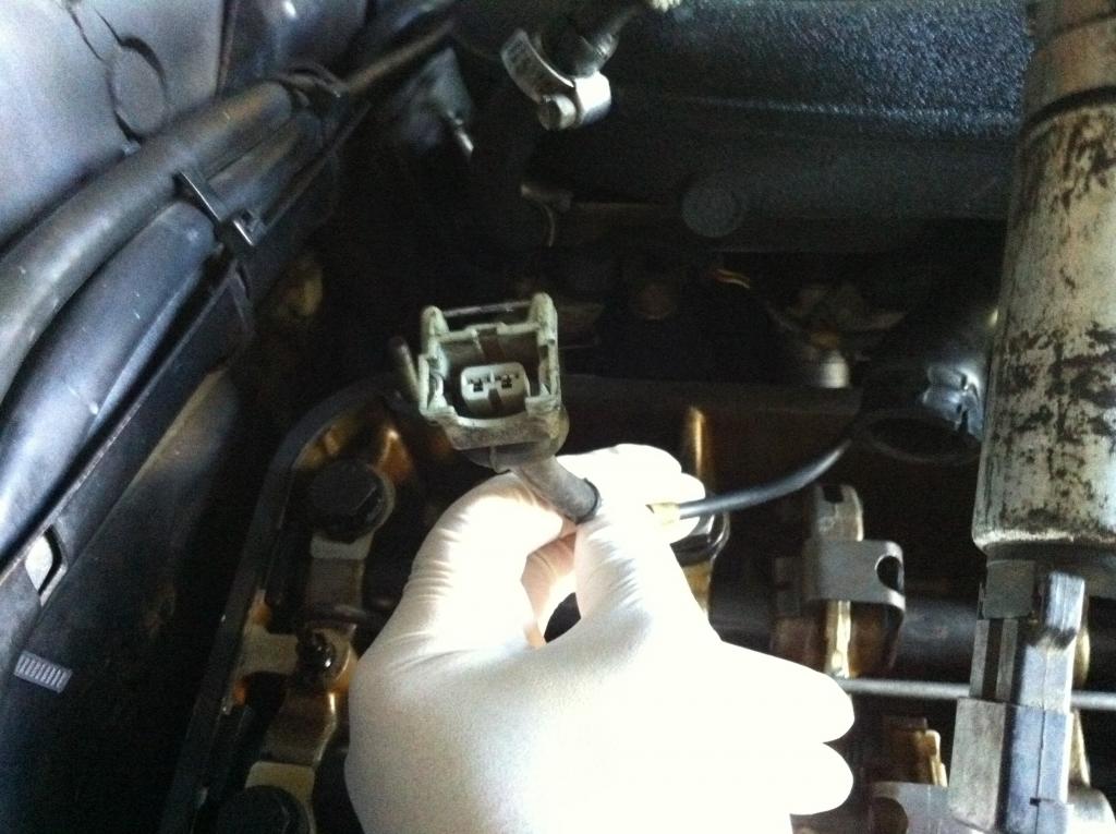

    I was reconnecting all my fuel injectors when I noticed this last clip but didn't have any more connections nearby to make. Can someone tell me where this one might go?
    This is towards the back of the engine, and all my tstat connections up front are complete
    Coolant temp sensor?
      i motor? That thingy under the intake manifold that goes to the charcoal canister? I can't think of what it is called, or the tps on the throttle body.
        ETA idle control valve?
          Need some info about the car buddy.
            Doh sorry guys. Yea its an Eta. I honestly can't find the other end of this thing
              Goes to a (now non existent) cold start injector.
                But I don't recall ever seeing a free flowing clip when I was removing everything. So this doesn't have to be plugged into anything? (its an 86')
                  are you sure you connected all the right plugs to the correct fuel injectors? you might of accidentally connected the cold start injector to one of the fuel injectors which explains why you would have an extra plug at the end
