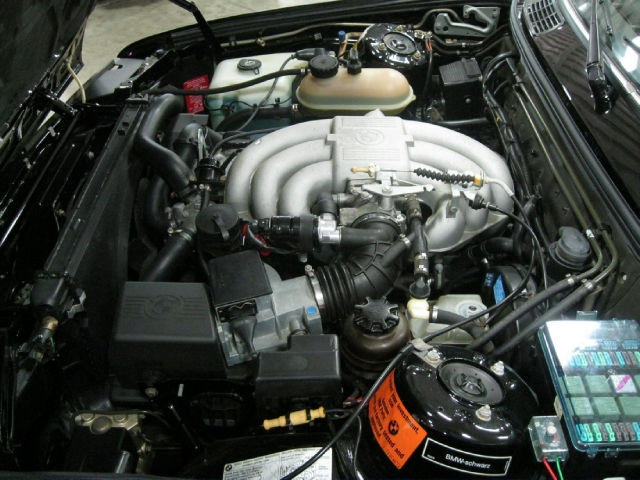

    What is this? Fuse? The extra item forward of the fuse box with the red and green wires???
    factory auxiliary fuse block, one has full time power, the other is switched power. slick solution to tapping into wiring for fused power. from the factory there is nothing attached to them, they were given to you for aftermarket accessories.

      Thank you, I've only seen a few cars with this addition.
      Thanks again for your help!
        That's a nice looking engine compartment. I have one in my 87 is and never really knew what it was. Thanks for the info.
          Not my engine!
          Just wanted to clear this up, it's not my engine, its' from a 1987 325is for sale in Grand Rapids, Michigan. It has 39,000 miles and they want $15,900!!!!!!!
