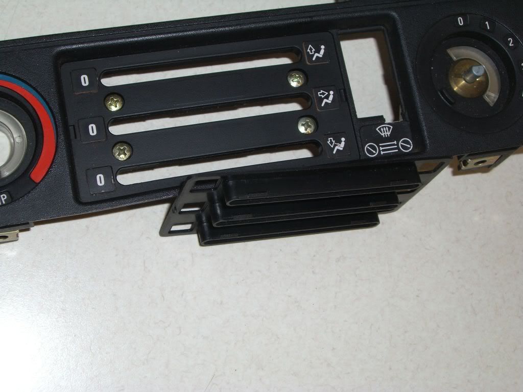

                Here are some pictures that may help.
                Heater Control Panel Back
                Heater Control Panel Front - Snap-on bezel removed. You can see the four screw heads now revealed.
                Heater Control Panel Side - Was hoping you could get an idea of the construction of the snap-on bezel from this side view.

                  Awesome that's the answer I was looking for! Thank you!
