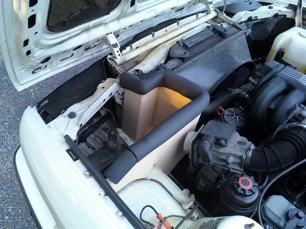

    Started this project a while back and has been on the shelf due to the lack of really helping performance in any way. But after getting it together I think it will help tidy up the bay a bit. Started by mocking up the spacing of the box over a weekend. Took my time and tried to utilize the space the best. Then traced out all the pieces onto 1/4" plywood and put the box together. Here is where I am at as it stands.
    I am going to bondo the gaps and smooth out rough spots then laying some fiberglass. Then painting it with some heat resistant engine enamel I think. Let me know what you guys think or if you have any suggestions.
    I have more pics but they are not on this computer. Will post them up later.
