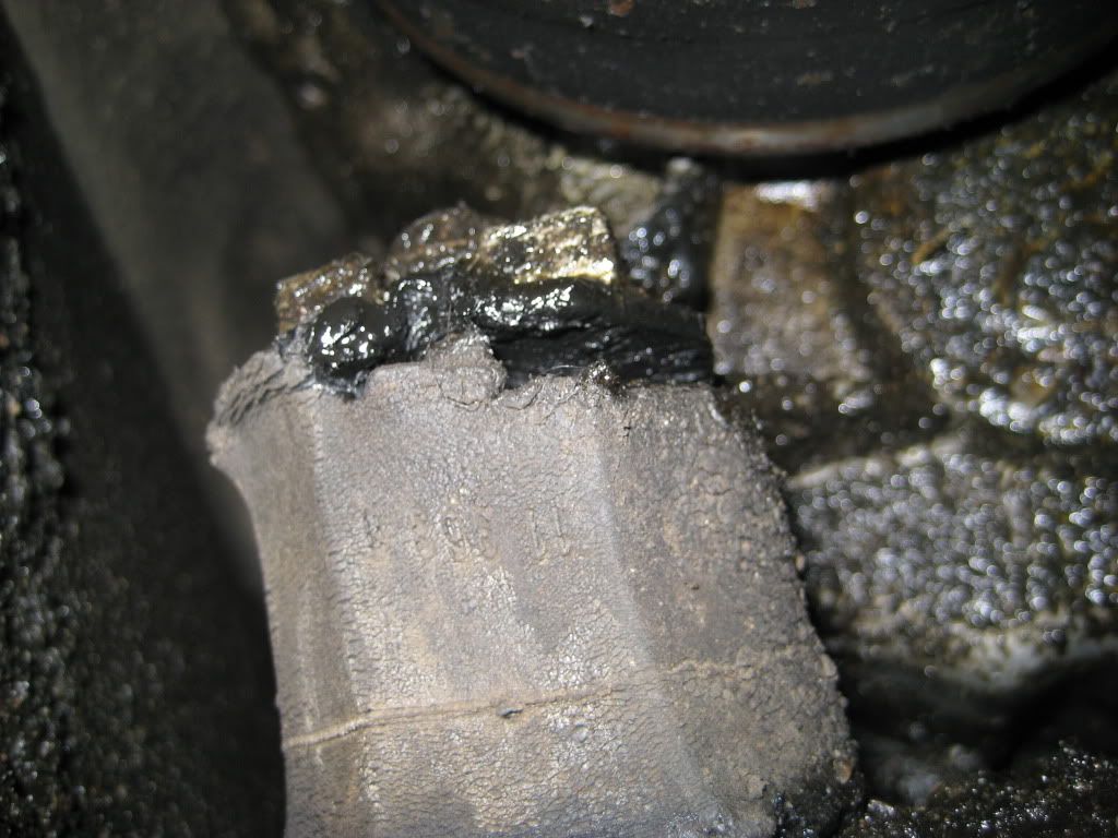

              My friend says it is the drive shaft and best to replace the guibo too. I checked the trans mounts by carefully jacking up the trans...they are definitely toast. How would i tell if my drive shaft is toast besides buying a new one and hoping for the best?

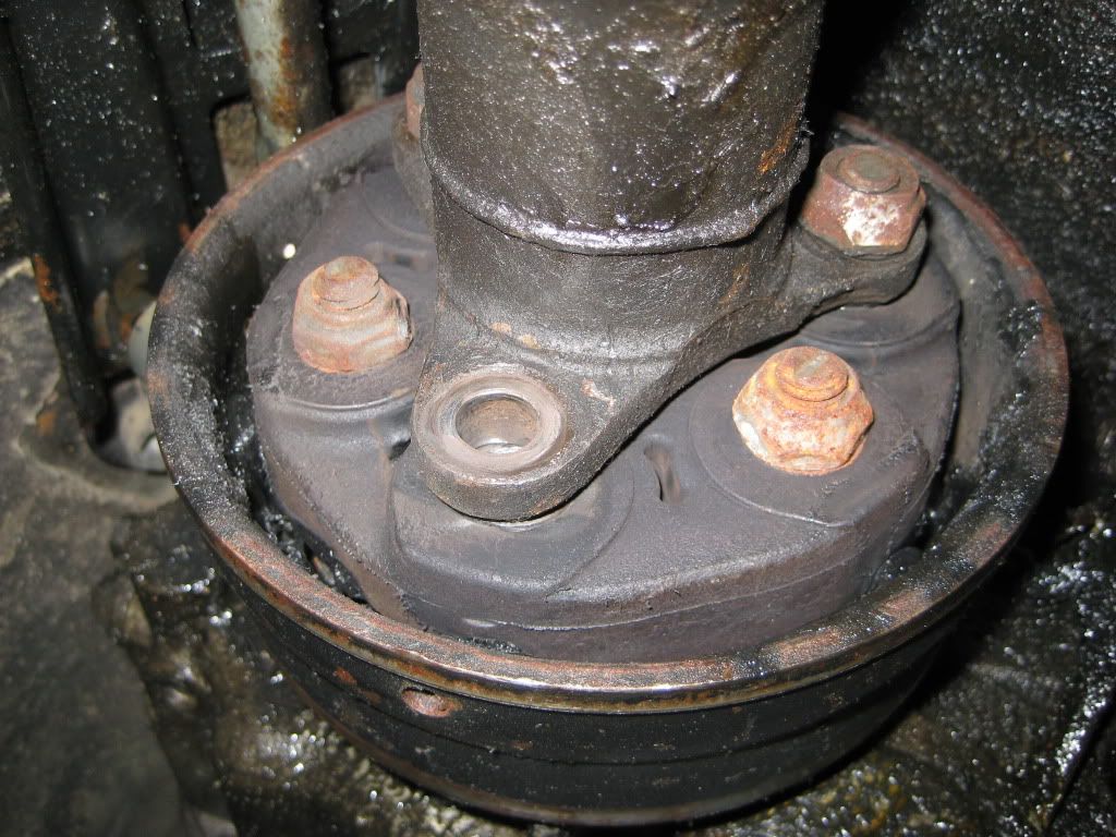

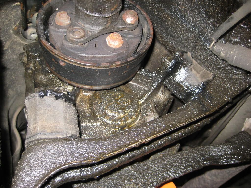

                I found what i believe to be the problems

                • GunMetalGrey
                  • Dec 2010
                  • 1499
                  lol! That will do it!

                    After preparing to grab the drive shaft out of the parts car, and getting the trans mounts out of it (the ones in the parts car are perfect!) i put the car in question up on ramps, saw there was a missing bolt and literally laughed out loud.

                        • e30trooper
                          • 11576
                          fuck that is dirty!
                          • accident
                            • 7303
                            Exxon Valdez.
