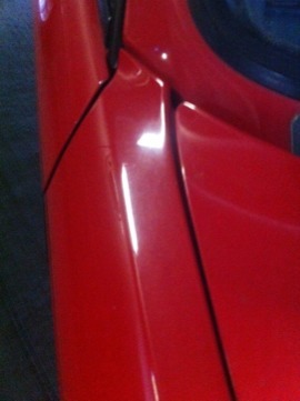

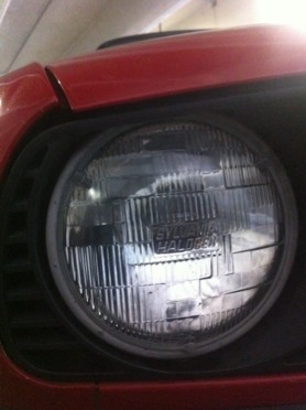

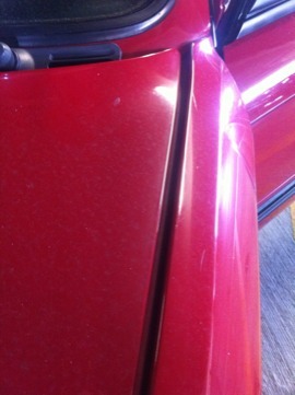

I recently installed a new hydraulic hood strut (oem) because my old one couldn't keep the hood up. The hood release cable is currently broken, but i've been opening my hood using a flat head through the grill. After installig the strut, I tried opening my hood but it wont open. The hood will pop open but it wont lift. I've always noticed that thehood is misaligned, however I noticed that the hood is misaligned more than usual. Could this be the problem? Anyone have an idea of how I can get it to open?
Hood won't open
That's definately mis-aligned enough to make opening difficult.
When the hood unlatches, yank it foreward first. That should release it from the rear guides.Comment
