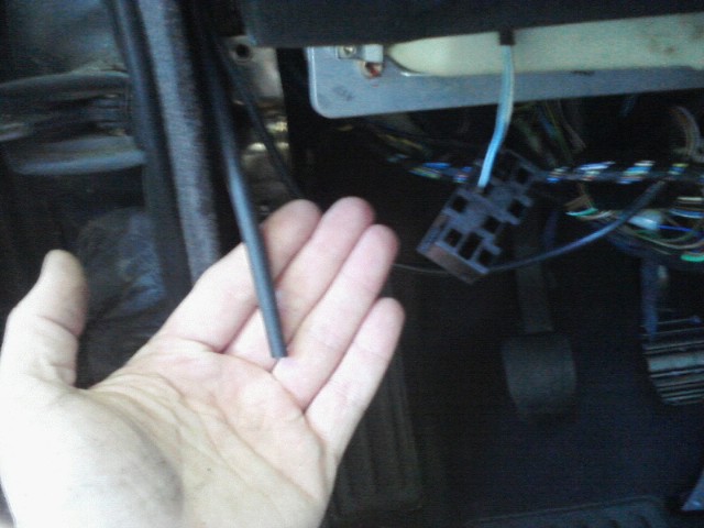

    problem fixed it was the sunroof drain and i will post pics how i fixed it and will clean it up when i get more time
    this was the sunroof drain i found

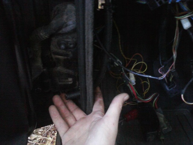

      i went ahead and got some fuel line and slid the drain hose into the fuel line. on the side buy the door hinge there is a little grommet plug i popped out and ran the fuel line threw the whole and zip tied it all nice and snug not too tight to where it cuts the drain closed. i will then drill two small holes around the whole in the wall and zip tie the hose tight to the car so it wont come loose and drain back into the car. i tried to see if you can see the hose inside the car with all the panels back on and its perfect. this is a quick fix it for cut sunroof drain hoses and it almost looks like it came that way.
      i will have more pics with everything back together in a few days as i dont get too much time to work on my car
