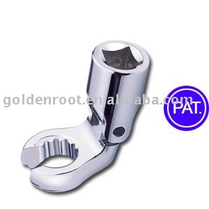

            • HR2L
              • 724
              Originally posted by Mullet Bullet
              or a crow's foot
              i need to get a set of these. my boy has these and they have been a life saver. I didn't even think about them. Thanks for the heads up! Going to pick up a set of these in 3/8 drive! Any brand recommendations? :)

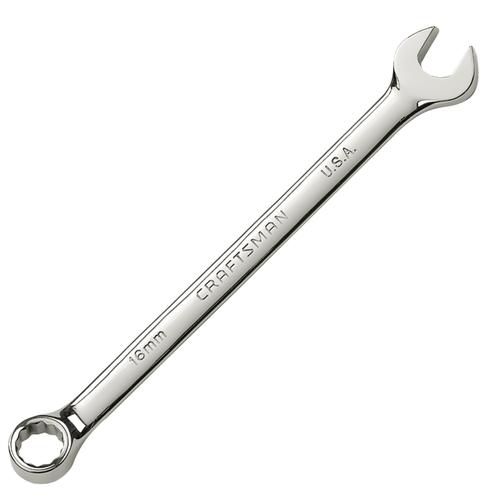

              • Mullet Bullet
                • May 2011
                • 904
                i only have snap-on and mac so other then that maybe craftsman?

                • HR2L
                  • 724
                  Does the snap on set in mm go to 19mm?

                          Unfortunately the 19mm deep socket I have is too large to even get a swivel socket/u joint adapter into (between the rail and the sensor). Honestly the Crowsfoot Idea is the best and looks to be the cleanest way in and out without any difficulties. Appreciate the input though. :)
