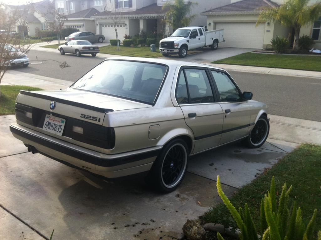

      more picture of your 4door bronzit

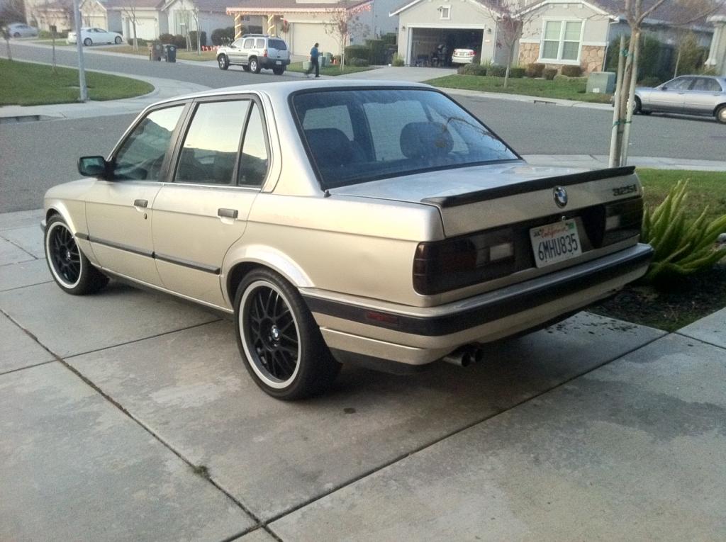

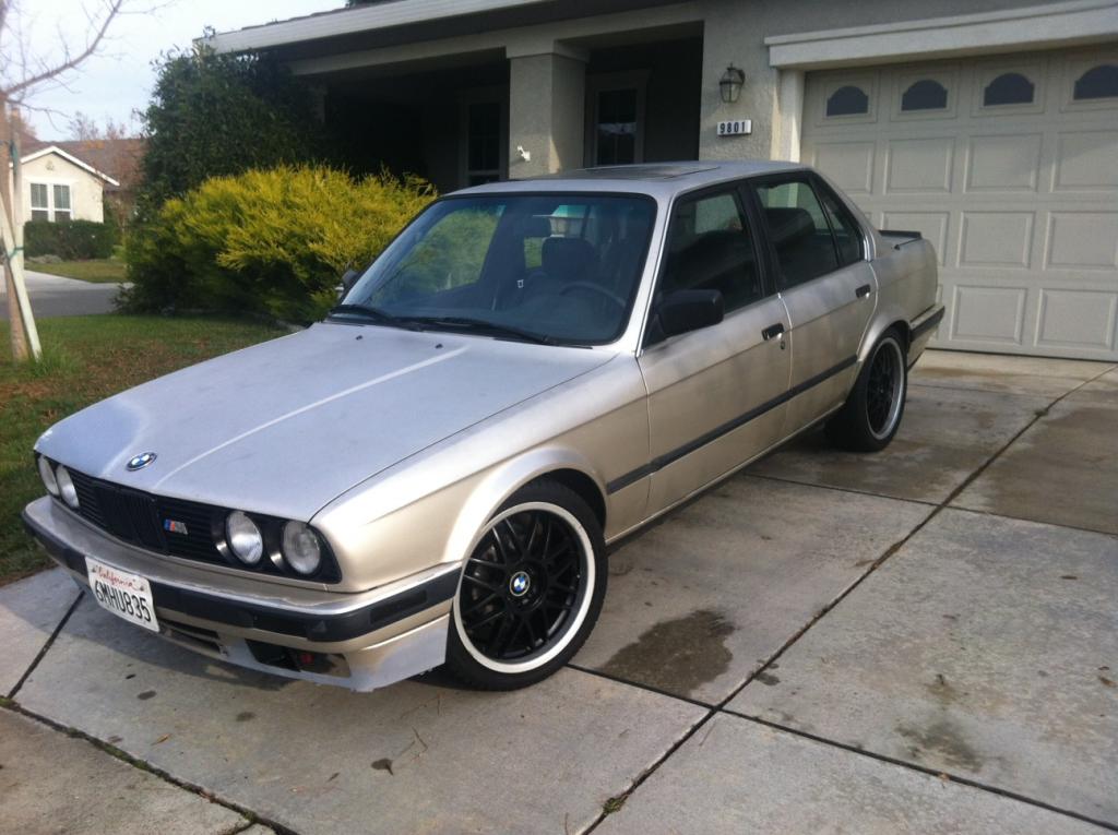

            I like it!! nice -especially, the wheels make it look slick.

              Dang nice ride man are those bbs asa wheels!!!

                Thanks guys! And they are racing harts lol. I wish I had some bbs's! I'm planing to paint the car a grey metallic color in a couple weeks. You guys like the bronzit??

                  aww man wish i had that color you got on your car why do you want to paint it that paint looks fresh

                      I kinda like the bronzit aha . but it looks fresh in the pic , but in person, its REALLY BAD. many chips and scratches. so i was thinking of going with a different color.

                        If you like how it looks you can just tuch it up with a can with that same color
