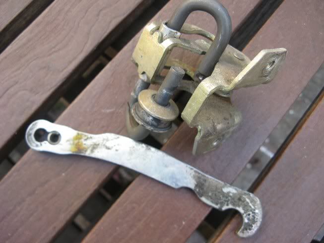

                    Update:
                    A break in the weather and a break in the schedule so today I pulled the part.
                    Much to my surprise, it had broken in ways I had no guessed.
                    The lower ear completely broken off. The top ear half way broken through.
                    A lack of grease was not the issue and I had wiped a lot of it away before taking these photos.
                    Thanks again to all who provided good insight.

                        All back together correctly and now operating with no door brake for the interim. Parts ordered along with a few door trim clips as advised, thank you.
                        The pin is still good so i skipped ordering that.
