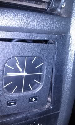

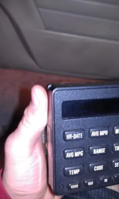

    So I have an '87 325ic. I just purchased an Analog Clock to swap out for the existing OBC. The clock was made to snap in from the outside, but the OBC was made to install from the inside. Is there another bracket-type piece that i can install on the inside of the HVAC panel? Or do i need to replace it for a different one? Thanks in advance for the help. Pics below:

    The analog clock bracket is part # 62-13-1-380-009. I got it from the dealer for $4.14, tax included. Its the same cradle/bracket as the 6 button obc if you can source one easier.

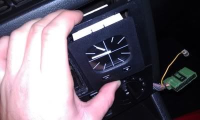

                      Hey guys need another favor. Trying to find some sort of wiring diagram/ instructions for an OBC to Analog swap. There are 4 wires on the analog clock but i have no clue which wires to splice on the OBC harness. Thanks in advance for the help.

                        Here the link I used to wire mine. FYI, if you dont have the pigtail, you can use a driver side power mirror pigtail in its place, Works perfectly after you shave down a tab.

                          Thanks, does this work the same way with the OBC wiring harness? Or does multi-function clock = OBC?
