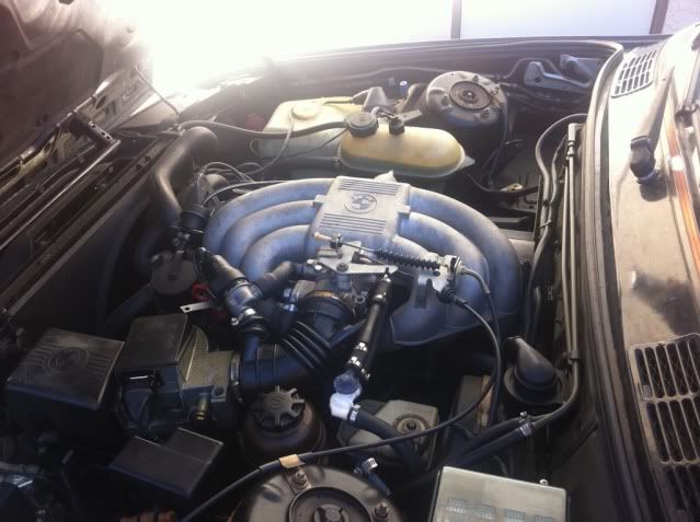

    im confused here.... ive been looking at gauge clusters for 325is's and they all go to 7K. i looked at my e30s today and mine only goes to 5K.... tripped me out so i checked the vin and its a 325is.... whats the deal?

    Pic of motor will solve this mystery. Cluster swapped at some point?

      Here's the only pic of the motor I have right now. Not at home.
      I thought about a cluster swap but why go backwards?

        Cluster is from an eta.

          Ok. So I need a new cluster. Awesome.

                  Total noob question but we are sure it's an M20 by that photo yes? I could figure it out if I was at home but I'm not and it's bugging me.... Cuz that would suck if it wasn't...

                    Its m20 either way.

                      Its definitely a m20b25. The intake manifold is a dead giveaway.
