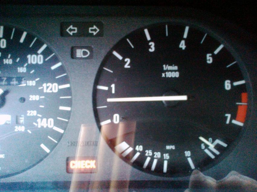

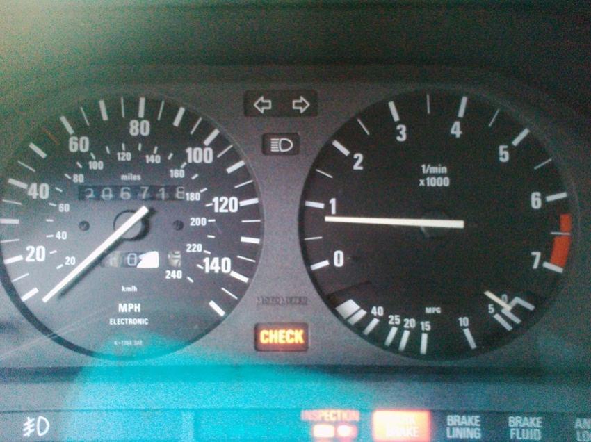

        I also unplugged the TPS and idled it. The car idled a bit higher this time and perhaps a bit more smooth but still not perfect. I attached pictures before and after? Which is a more correct idle? Do I need to adjust/replace my tps?
          The Lambda fault at idle that goes away when the engine speeds up, the rough cold idle, the hesitation from idle on a cold engine, and the less than smooth idle all suggest intake leaks, possibly aggravated by an aged O2 sensor.
          The O2 sensor is a scheduled maintenance item with a replacement interval of 100k. If that applies, replace the sensor and have a smoke test run (properly) and fix the leaks it reveals.
