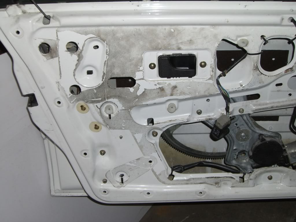

    I've got a new-to-me 91 318i 4 door with a lousy driver's door lock. I got my door lock rebuild kit from Pelican today. Wife and kid out of the house tonight - perfect time for a quickish little project with small parts. I used this thread for a step by step. Unfortunately, I didn't even get to the rebuilding the lock part, because my door is not designed the way that this thread (or Bentley) show.
    I'm talking about this:
    Instead of a nice wide open space behind the weather sealant, I have a more or less solid steel panel. There are a couple of holes in the panel, but no large spaces where you can get a good look at everything/get a hand in. I could barely see the retaining clip, had a hard time imagining getting it out, and I know I couldn't get it back in.
    I decided to button it back up and seek guidance here. Has anybody encountered this? Do I have to take the door panel apart to get to that lock? Any help? I, of course, didn't take pictures while I was in there. :?

      Thanks for the help, but I must not have explained correctly. The picture is what a normal e30 door looks like. My problem is that my door doesn't have that big hole behind the plastic. As a matter of fact it doesn't have any plastic. Just what appears to be some foam soundproofing. Has anyone encountered this before, and how would I get a lock in/out?

          Pics would help

            Did your inner door panel fall apart? Sounds like someone was in there before, and either replaced the plastic with foam or forgot the plastic entirely and your sound proofing welded itself to your door.

              pics would help

                It does sound like the previous owner sealed the holes and soundproofed over. You will likely need to peel back / off the soundproofing in order to determine how the holes were sealed (glue, tape, welded, screws, etc.) and with what (wood, metal, fiberglass, etc.). Only then will it be possible to determine how to proceed.

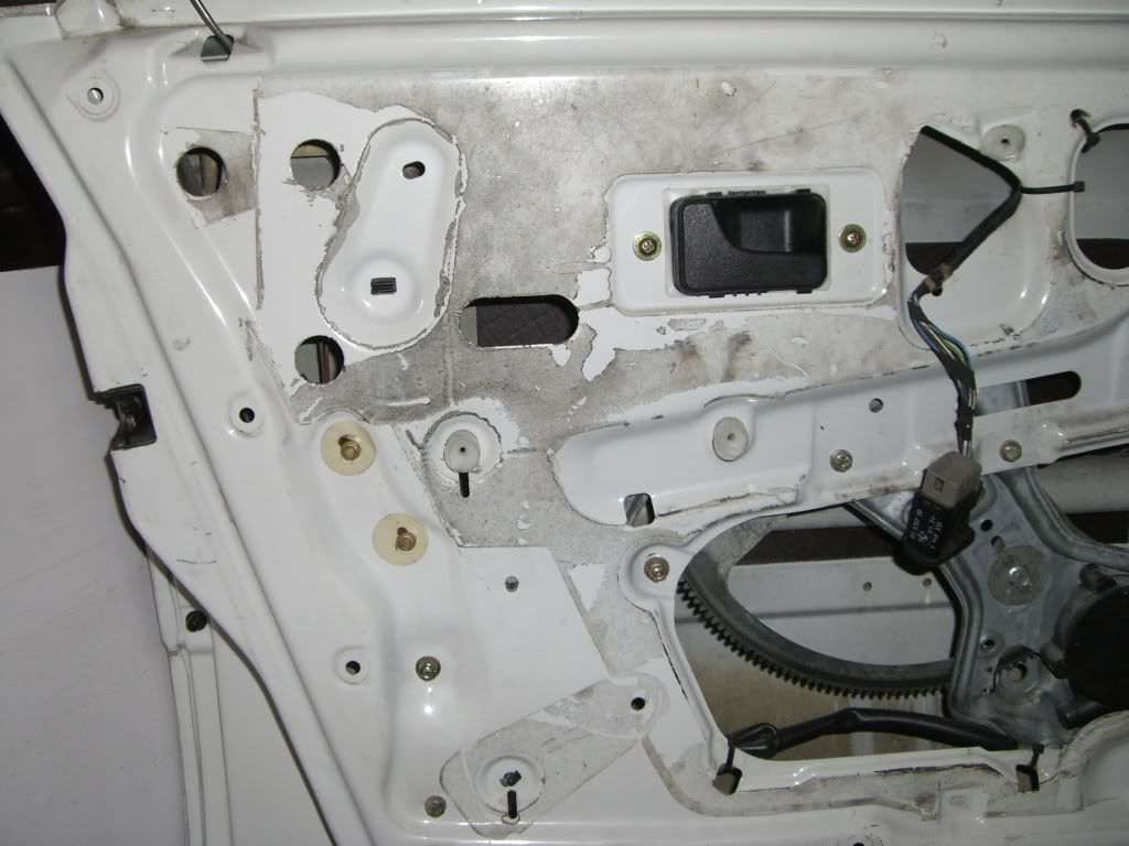

                  I'll attempt the job again tomorrow and post pics. I wish I had pics to express what I was trying to say, but the entire panel is OEM steel, painted OEM diamondschwarz. That's what's behind the soundproofing. There is no opening in the door, except for a few holes no more than an inch across.

                    Ah, yes. Now I understand. The sedan doors ARE different from the coupe doors pictured in the tutorial.
                    The sedan doors simply require you to fish your arm up a little farther (from the big hole down farther in the door) in order to reach the lock. It is possible. I've done mine (pictured). It does take some perseverance. The screwdriver (or other lever) is inserted through one of the smaller holes near the lock mechanism (you can shine a light into another one of the holes near the lock) and your hand / fingers just guide the tool to the proper location. If you drop the clip when it pops off, it is easily retrievable from the base of the door with a magnetic tool. Reattachment is possible in this same manner.
