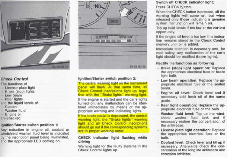

    The light goes off as soon as you step on the brakes?
    Normal operation.

      Owners manual
      -Dave

        I kinda worded that wrong. My light in the check panel stays on 24/7. I know its suppose to go off when I hit the brakes but doesn't. I actually replaced the brake switche, All the taillight bulbs, cleaned the sockets for the bulbs, replaced the 3rd tail light, cleaned the connectors for the 3rd brake light, and replaced the brake light panels with ones off another car. Still stays on....
