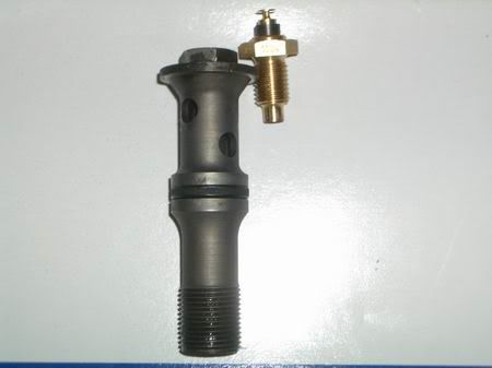

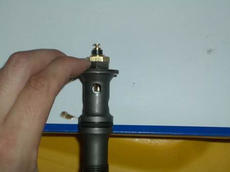

    I've taken a leaf out of Alpina's book, and want to mount my oil temp sender into the hollow bolt that holds the oil filter housing to the block. In fact, I had the Alpina parts to do this, but it turns out none of it is compatible with my M20B25 with oil cooler (the bits I had are ex-M20B23). So, I've removed the hollow bolt from my car, with the intention of having a hole drilled in the head of it, tap it, and then mount the sender. My only concern is that sender itself may impede oil flow. Here's some pics to demonstrate:
    As you can see, the sender will penetrate a reasonable way into the bolt...I just have no idea how far in is too far. Any thoughts on this???
    Cheers,
    Drew.

    I know a LOT of people have mounted it there, and I plan on doing it myself.
    My sensor is not as deep though (E30 M3 OEM Sensor)
    I know Jordan did it that way.

      The OEM sender would have been a logical choice...but it'll cost me a fortune here. The VDO was only like $30 AUD.
      I'll see how I go...a washer or two will probably clear enough space to give me peace of mind.

        I have mine there.
        No problems.
        Thats a huge passage compared to some the oil gets pushed through. It has alot of pressure behind it, and it doesn't compress well. It will go where it has to.

                      I mounted one there on a customer's car a few years ago with the E30 M3 sensor and it's been fine; and it's a pure track car.
