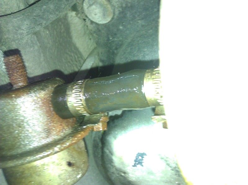

    Just looking for a step-by-step for my '88 M3, since I discovered this over the weekend:
    Just bought a new fuel filter, 3 meters of fuel hose, clamps and 3 random pre-bent hoses I thought I needed from bmwmercedesparts.com. Now, I need to figure out the steps to getting to all of the lines. Tried RealOEM but I can't quite figure out everything.
    This should be the same for all E30s, M3 or not, correct?
    Just take out the old line one piece at a time and cut the new line accordingly. You might need a razor to slice the ends to take the old lines out. Remember to release the pressure first (run the car with the fuel pump fuse removed). Do one section at a time and you will be fine. Work in a well ventilated area. Most importantly, disconnect the neg cable BEFORE you do anything.

      Which is the fuel pump fuse?
        And make sure to use fuel injected rated hose, not carb rated fuel hose.
            Fuse 11 controls the fuel pump. It is also best to unplug the fuel pump relay.
