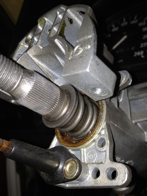

    Replacing my ignition and switch. Got everything disconnected but im trying to remove the spring and lock washer so I can slide the housing off. How is this done? See pic. Thanks Click image for larger version

    I'll quote this from the Bentley repair manual as I'm going to have to deal with this on a 1990 325i convertible:
    "With the trim and the steering column switches removed, remove the collar, the snap ring, the washer, and the plastic sleeve, in that order from the end of the steering column. Then, use two screwdrivers to pry up the upper steering column bearing. With the electrical harness connectors disconnected, chisel off the head of the shear bolt. Then remove the steering lock mechanism from the steering column."
    Hope this helps somebody.
