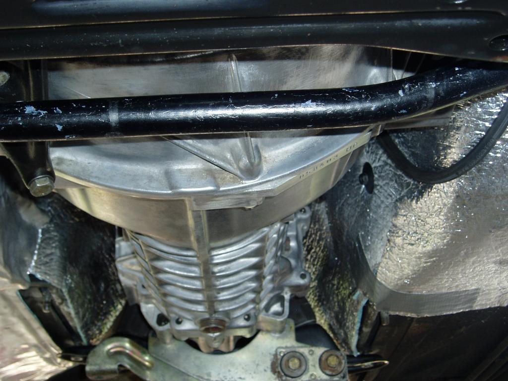

      I've done this on a car I'm restoring. There are a number of things one can use, but I wanted to keep the factory look. So I used Eastwood's DynaLiner. Piecing it in was a bit tedious, but it came out well. The result looks like:

                      I just pulled the motor out of my E30 and discovered that the liner back there is trashed as well. Since it's about $90 to replace, I thought I would look at DynaLiner as well. I worry about two things:
                      1. It's only rated to 200F, which I suspect is enough in that area, but I'm not entirely sure.
                      2. The cost of it looks about the same as just getting the OEM piece.
                      Last question, for people that have done it - how much equipment do you have to pull to install the factory piece? Looks like the brake booster has to come out (at least) and maybe some other parts as well. This feels like a place where the DynaLiner wins because you can piece it around things.
