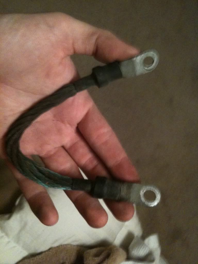

            Check the ground strap on the engine. It connects from the frame rail to the oil pan on the drivers side of the car.

              does it need replacing? It has a somewhat green residue

                ive seen worse ones that worked fine, its usualy just when it is loose or not connected that it will cause a no start, have you checked what voltage your getting at the starter terminals compared to at the battery, i would check what the battery is putting out against what you get at the power block on the firewall and also against whats at the starter terrminals
