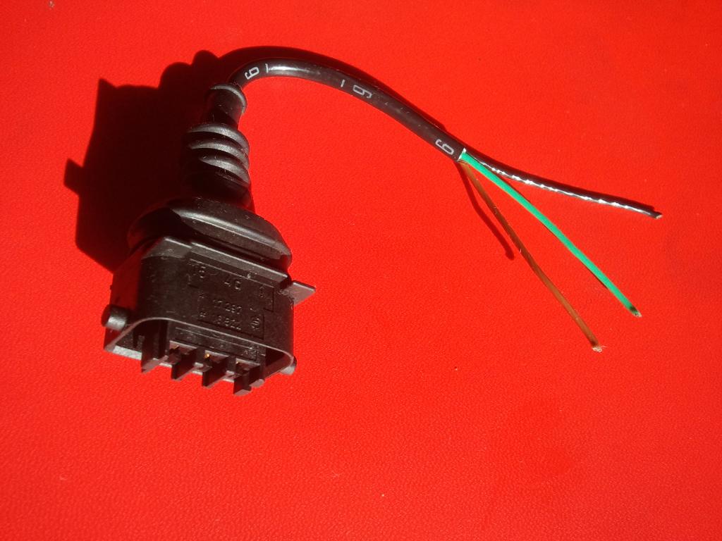

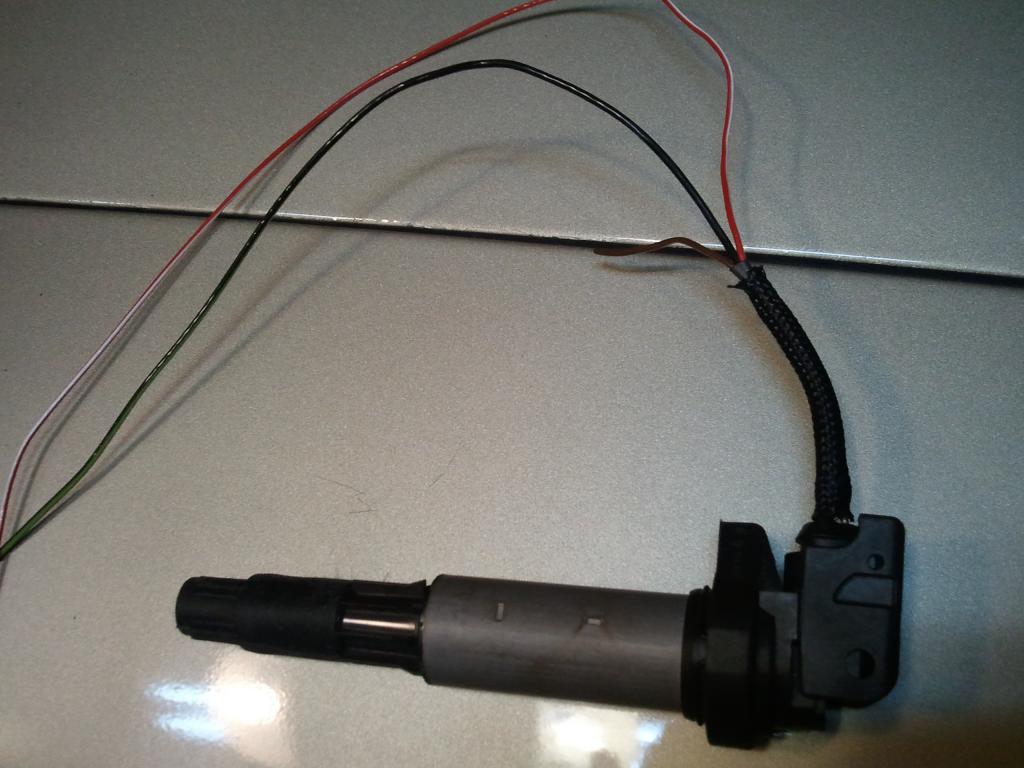

    'am in the process of changing my coils to pencil coils and wanted help with wires color coordination. What wire colors goes with what?
    Wire Colors
    1) Brown, Black, Green (regular coil)
    2) Red/White, Green/Black, Brown (pencil coil)
Name:	2012-07-14 17.54.11.jpg
Name:	2012-07-10 23.48.32.jpg

    Brown will always be ground (coil side). Black is the control side, and red/white and green are your power from the ignition.
      Thnx man for helping out on your first post, brown definitely goes with brown.. So the rest will be red/white goes with green, green/black goes with black.. right?
      • rudenate
        • Jul 2012
        • 16
        That's correct. The control side will always be a black/x color combination, that particular one is cylinder 5.
